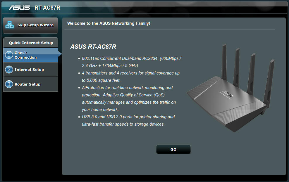

How to turn an RT-AC87R into an RT-AC87U:
(Used serial port to make change to NVRAM right after first time boot and before making any changes through the web GUI.)
(I did this to show the initial boot-up screen, but the odmpid variable can be modified at any time and using Telnet.)
/ # nvram get odmpid
RT-AC87R
/ # nvram set odmpid=RT-AC87U
/ # nvram commit && reboot
RT-AC87U
