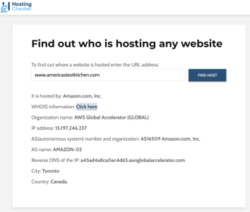

For some reason this configuration has some sort of problem on iOS and iPad OS resolving some names. In particular, it has trouble resolving https://www.americastestkitchen.com - something particularly useful to me during this time of year! Every single other device in the house including MacOS, Windows, Android and Chrome have no trouble with this configuration. This is not the end of the world, there are other DNS servers out there, but I like Quad9 for security and privacy. Plus as somebody who always taps the "Did you check DNS?" sign in the office when things happen, I feel like the DNS spirits are out to get me.
