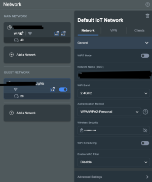

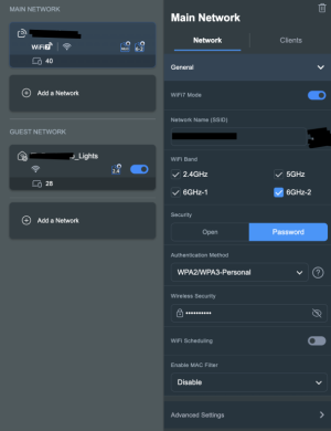

- Tried initial setup through app, created Wifi 7 network with MLO that had the same SSID as my previous mesh wifi network - my previous mesh setup was an XT8 system, also with 2 nodes.
- Nothing could connect, I setup additional networks, still struggled - so I did a hard factory reset
- Started fresh - again, Wifi 7 network with MLO, using original SSID, setup separate 2.4ghz only IoT network, manually reset every device to connect to IOT network with new SSID (OldNetworkName_Lights)

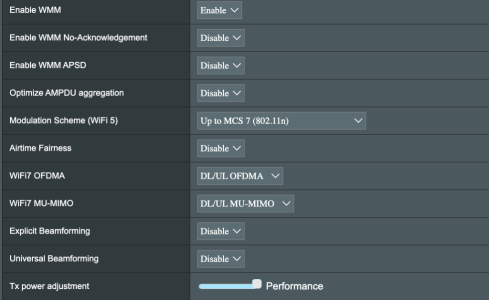

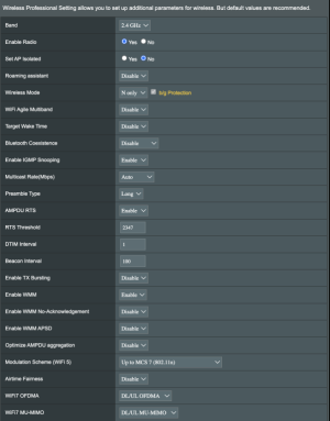

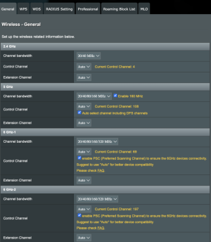

- Still having issues, tried recommended config for 2.4ghz network (see attached screenshot)

I do have something to share. The MLO broadcast is not compatible with prior WiFi generations. There is, at least on the BE98 Pro, a MLO tab where there is a toggle switch to turn it off and on. Toggle it off then on. Upon turning it on there should be a pop up. The WiFi 7/MLO SSID should be different. The second one should be the "Legacy" SSID, which should be the same as your old SSID for the non-WiFi 7 devices.
I actually tried creating a separate IoT network in the past, then tried starting to move IoTs over, to great difficulty. I ended up keeping them on the main/Legacy SSID, to this day...
Heh - I spent almost an entire day trying to move my IOT devices over. And it would fail about as often as it would succeed, which just increased my frustration,.

My 2.4ghz spectrum seems crowded because some of my neighbors are running in 40mhz mode :(.
A lot of devices don't support the 256 bit encryption that enabling MLO/WiFi 7 mode turns on, that's why it also enables a built in IoT SSID. Only really my Apple devices support the higher level of encryption, my other devices don't even see the SSID.
Thanks for sharing that. I turned off Wifi 7 mode on my SSID - interestingly, the backhaul is still running MLO but the network itself isn't.

FWIW, I was able to fix my IoT issue (same as OP had) by only changing one setting. "Modulation Scheme (WiFi 5)" set to "Up to MCS 7 (802.11n)". This setting is located at: {Left Bar} Advanced Settings > Wireless > {top tab} Professional. It is the 8th item from the bottom. Hope this helps someone else prevent the spontaneous acceleration of a brand new router into the nearest solid structure.
