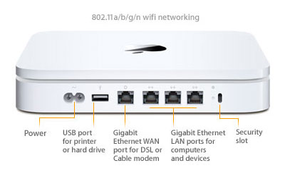

My data path is the following:
(INTERNET) --- Cable 120/10 Mbps --- [Cable Modem] --- CAT 6a 1 Gbps --- [TimeCapsule Switch/Router] === 2xCAT 6a 1Gbps === [DS1511+]
The TimeCapsule is also connected via a CAT 5e cable to a Devolo AVMini 500 Mbps Homeplug device to allow network over powerline in the house. 4 security cameras are connected with other homeplug devices and controlled via the Surveillance Station running on the DS1511+.
A 3TB HDD is also plugged in via USB in the DS1511+ to backup some of its folders and settings using the Time backup
