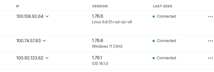

Tailscale gives clients addresses in range starting 100.XXX.XXX.XXX. I have tailscale running on my Rpi, desktop and mobile. Apparently I should be able to use the 100 range addresses to connect to another device but it always says connection refused.

Works fine for me. How are you testing this connectivity?
Just to be clear. I havent installed Tailscale on my router. Im using my RPi as dns for network. I turn off wifi on mobile then connect to tailscale on my mobile 4G. Then try to connect to RPi with tailscales provided 100.xxx.xxx.xxx address or raspberrypi.tailXXXXts.net address and it doesnt connect.

Can you ping the tailscale addresses of the RPi and Windows machines?
Your Asus router isn't running tailscale therefore it doesn't have a tailscale address!
Perhaps those device/apps are NOT listening on the Tailscale networtk interface, and/or there are personal firewall issues. We know the connectivity and routing works since ping works.

Other than the RPi what other tailscale devices have you tried to connect to? As far as I can see you only have one other device (in addition to your mobile), the Windows PC.

Yes I haven't connected any others as I wanted to gradually add more as I got it working correctly. As you said it may be due to ports not listening or firewall issues.
