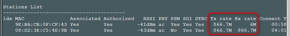

I want to get the Tx Rate/Rx Rate like as below
