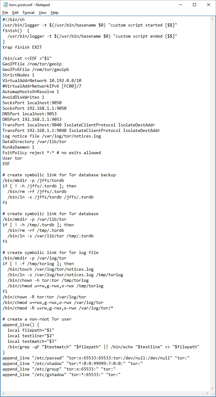

Tor is running fine for me on Asuswrt-Merlin 380.68-alpha1. However, I'm using Tor 0.3.0.10 upgrade, and a homemade /jffs/scripts/torrc.postconf
https://cryptobin.co/36s0b7v3, password is lol
