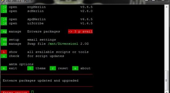

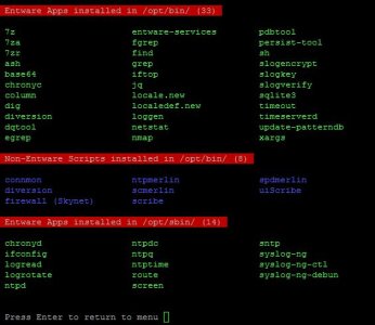

Not sure if this is related to topic. can someone advice me on whats going on with entware update through amtm. it states updated but returns package 3 p available. i try again to update and no luck. see attached
fixed in repo
