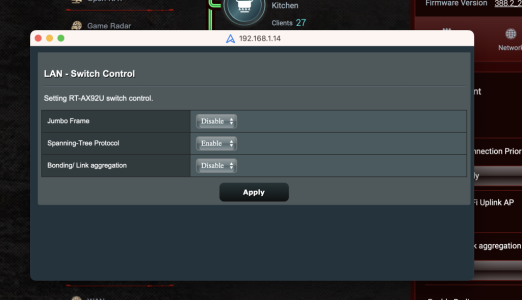

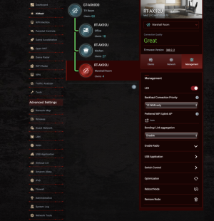

Adding some screenshots of setting, which are pretty much the same for all three nodes.
