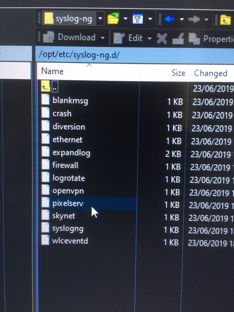

I use WinSCP and followed these instructions
Just for fun I added these from the examples file
To remove pixelserv I went to this file and deleted pixelserv
I then went to this file and deleted the pixelserv file from there as well
I then run functions lr and rs in scribe
Ignore my method of deleting it and do as L&LD suggests [emoji4]
Am I the only one cringing here? :)
Why not just disable it via the Diversion menu? ;)
I’m cringing now you mentioned that, it didn’t occur to me [emoji85]Thank you for picking me up that one [emoji4]
