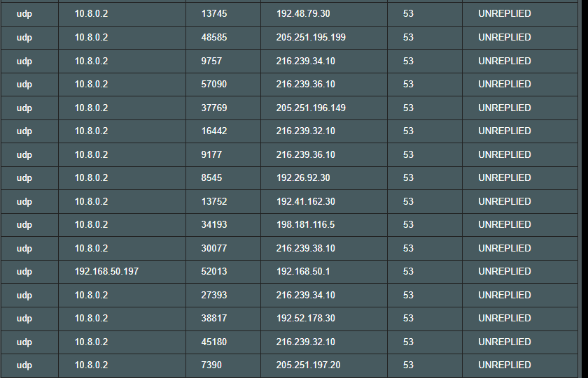

I took a look at the connection tracking, and am seeing this... the 10.8.0.2 is my tun14 IP...
When I ran tcpdump:
tcpdump -i tun14 -nn -l udp port 53
... I get zero results... even tried going to some websites I've never been to thinking that they wouldn't be cached, and would force a lookup.
When I ran tcpdump:
So, the silent good news is, Connection Tracking has identified my hypothesis. You would not be able to observe port 53 traffic (atleast not in the way you hoped). However, Connection Tracking shows that majority of your traffic for DNS is indeed unbound VIA your VPN.
So that's good news... ;) What's your theory on this? Using Eibgrad's DNSMON tool, it shows DNS requests going out over the VPN, but it almost seems like their replies are coming back to the WAN? One would think if they go out over the VPN, they would return over the VPN?
When I ran tcpdump:

none of that is DNS traffic. You’re picking up the :53 seconds in the timestamp.
OMG. Looks like you're right on that... DANG!
