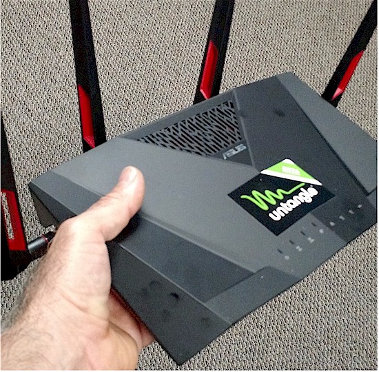

Untangle at Home brings a full-featured UTM router within reach of consumers.
Read on SmallNetBuilder

Nice to see that it can come preinstalled on a home router.

After looking at all the features of Untangle its really deserves a pc build of its own to truly unleash it. Wish there were more Quad core + 1gb ram routers available with better pricing!
I think it's pretty impressive that they've put a lot of effort into getting this running on a device like the RT-AC88U - but with all the bells and whistles turned on, performance with a large number of users could be challenging...
Something like the Zotac I mentioned above, or better yet, the QOTOM J1900 boxes (just saw on the Amazon for $200USD) would run Untangle very nicely... they ship barebones, so 4GB RAM and a Small SSD, so in reality, it's probably around $275-$325, and probably want to get a desktop switch (another 50 or so)... but for routing, it would run circles around any BHR...
