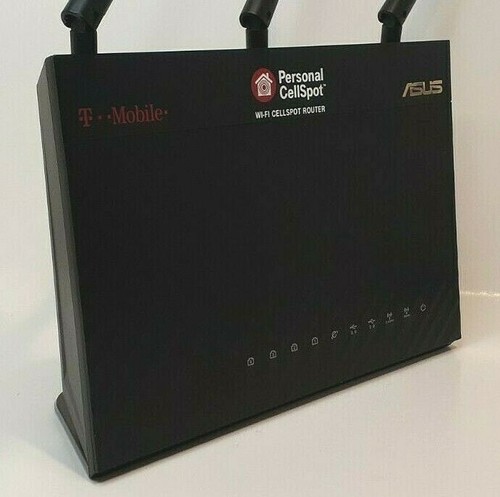

On top of all of the above considerations, are we absolutely certain that this is a genuine Asus RT-AC68U, and not a re-flashed T-Mobile device? Just bringing up the possibility, as that will also add additional upgrade problems, and is a completely unsupported configuration.
Im relatively certain it is? Now you have me wondering. Is there a way to tell? There doesn't appear to be any T-Mobile badging on it. I did read up on those...aren't they the same exact hardware, just with t-mobiles version flashed on it which restricts a lot of the features? My reading on the topic said that you could wipe out the T-Mobile firmware and turn it back into the 68U and it was functionally the same as factory?
Unless someone went to great lengths to pull off or hide the original T-Mobile branding, it is likely a genuine Asus RT-AC68U. Asus has now added additional hardware checks into the firmware to help prevent cross-flashing these: it might still be possible, just getting harder and harder. Regardless, this is illegal, as it violates the licensing terms of some of the add-ons included in the genuine Asus firmware (Trend-Micro, etc...). There is a sticky thread at the top of various parts of these SNB forums explaining it further.
@SFCRangerDOc It's very obvious from the case branding and the model number printed on the label on the back.
