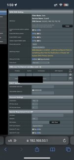

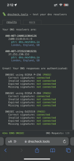

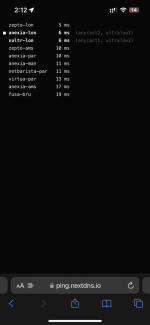

I was using NextDNS on one of my AX86 router, I am behind CG-Nat using Skynet. Only switching to Quad9 wan+privacy dot works. Not sure what changed. But routing table was odd with Next DNS as WAN dns too
It worked fine one version back even with NextDNS. And I need this for filtering of traffic. Have been using it for years at this point and it has been great. There were issues with stubby in the past but something got fixed and now it's broken again.
Mine is working fine now. No third party scripts installed tho. Wifi has never been solid but my WAN dns set to Quad9. The only adjustment I need to make was the rebind protection. See this thread
This is my spare AX86S tho. The main AX86U using amtm Diversion, Skynet, Ntp merlin with Quad9 TLS.

Why u using quad9 with nextdns? Look like domain dns lagging ping beween 2 server so far, rite?
