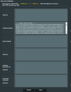

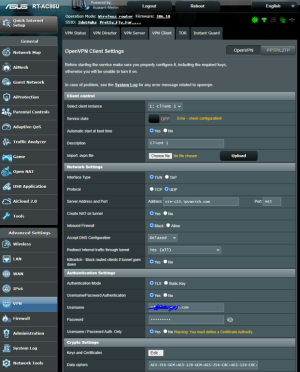

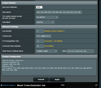

I guess it'll be something I have done wrong, but could someone please help me diagnose why my VPN is no longer working since upgrading to 386.10?
I use IPvanish, specifically their Charlotte 6 server in my merlin for a number of years now without issue. But since upgrading to 386.10 it has been unable to connect and I get the "Error - check configuration" message. I have tried an Austrian server, but same issue persists.
I have made sure the CA is populated with the correct key from IP vanish (see attached) and my credential are 100% correct. But still no joy!
Any help would be much appreciated.
Mar 27 18:58:45 rc_service: httpd 1185:notify_rc start_vpnclient1
Mar 27 18:58:45 ovpn-client1[5020]: WARNING: Compression for receiving enabled. Compression has been used in the past to break encryption. Sent packets are not compressed unless "allow-compression yes" is also set.
Mar 27 18:58:45 ovpn-client1[5020]: Options error: Unrecognized option or missing or extra parameter(s) in config.ovpn:33: keysize (2.6.0)
Mar 27 18:58:45 ovpn-client1[5020]: Use --help for more information.
Mar 27 18:58:45 openvpn: Starting OpenVPN client 1 failed!

I am not tech savvy. I have the same issue on my RT AC 5300 Asus router. What is keysize?
Its in you vpn config file. Remove it.
sdikgetsi, as an example, the below is an IPvanish OVPN config file for a Dubai server. Open your preferred file in notepad, then delete the line that says "keysize 256". Save, then upload that to your Asus Merlin.

Thank you, alecmascot. I am now connected again! :cool:

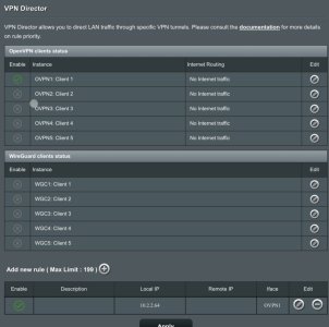

What do you have configured under "Redirect Internet traffic"?
Have it as shown in 2 snapshots for VPN Client tab and VPN Director tab. I am thinking of rebuilding starting from scratch at some point
anyone had issues connecting OVPN using UDP. I had issues connecting my cameras remotely using UDP protocol when upgraded to 388.2 on AX-86U. Used to work perfectly - I had to change to TCP protocol and then everything works ok again.
