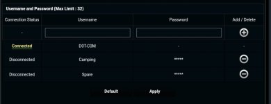

How do I get each client to have their own username and password? I tried enabling the 'Username / Password Only' setting but it does not seem to change anything. The vpn client only authenticates when I use the default username and password. It doesn't authenticate when the usernames/passwords that I created are used to login.

I'll try your suggestions later tonight when I have time in the meantime here are the general and advanced server 2 settings. If those are too blurry I'll get screenshots from my computer tonight

I tried disabling Manage Client-Specific Options as you suggested unfortunately only the default username works.
Well based on those last snapshots you posted, you did NOT disable MCSO. You simply removed the entries from the MCSO table. I want it OFF, entirely.
I'm suggesting this because we KNOW that the ordinary use of multiple usernames and passwords works. I'm thinking there's something else going on here once MCSO is enabled that breaks it. I just don't know what that is at the moment.
