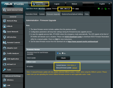

So I had a look around and came across the ASUSwrt-Merlin firmware. I know that my router is no longer supported, but nevertheless I found a new compativle firmware: RT-AX56U_3004_388.8_4 (17-Nov-2024).

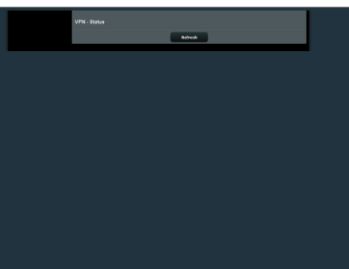

After flashing this firmware all seemed to be ok, but when trying to activate the VPN settings, I couldn't find any setting for VPN server, VPN client, etc. There was just a blank screen except for a short message that said something like “Refresh ...”.

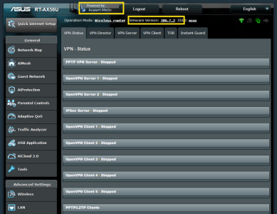

I then tested a relatively old Merlin firmware RT-AX56U_386.7_2 from July 2022; the VPN settings were possible there.

So, I've tried everything; my skepticism was unfortunately justified!
A factory reset didn't change or improve anything. The settings for VPN are simply missing! I have backed this up with screenshots.
When I try the old Merlin version RT-AX56U_386.7_2, the VPN settings are visible (see screenshot).

A Javascript error is preventing the page from loading. Open the browser console and look for any error message.
Also, try a different browser, your issue may be caused by a browser plugin such as an ad blocker.
That was the reason!!! Thank you very, very much.

Sounds like a browser issue. The first syntax error it reports is something that works in every other browsers.
Thu Jan 02 2025 10:29:57
Fehler: SyntaxError: invalid regular expression flag s
Quelldatei: http://192.168.1.1/Advanced_VPNStatus.asp
Zeile: 532, Spalte: 34
Quellcode:
var fields = data[i].split(/:(.*)/s);
