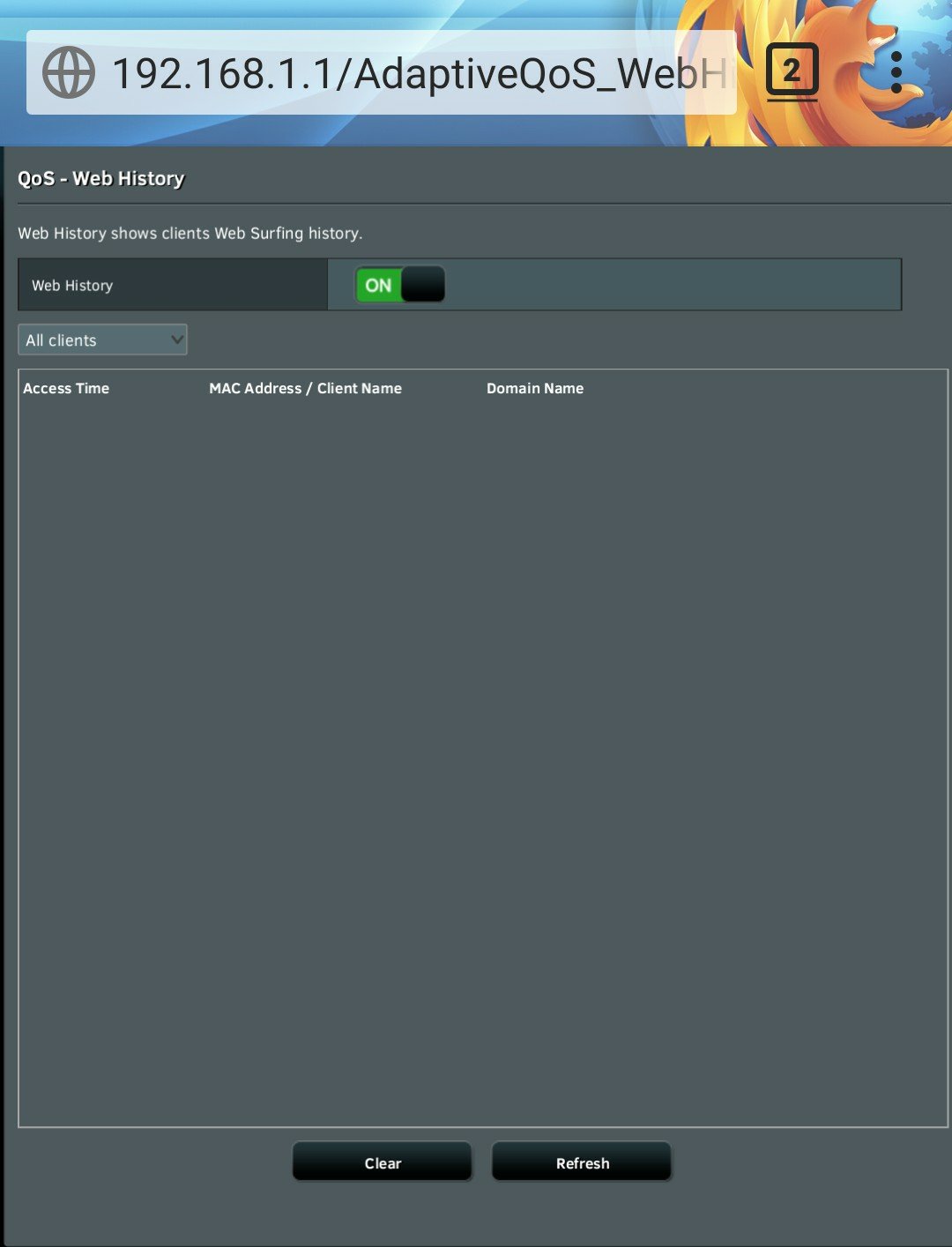

Web History not working

Found this forum because this is happening to my RT-AC68U, I ran the code mentioned in a earlier post and some logs show but they never update, it just shows from the day I ran the code.
Any more info on fixing this?

I have a RT-AC68U that I just upgraded to Merlin 384.5.
My Web History is not working. Shows up exactly how the original poster of this thread showed.

This might get it unstuck for you guys.
WebHistory
/usr/sbin/WebHistory -e
AiProtectionMonitor
/usr/sbin/AiProtectionMonitor -e
TrafficAnalyzer
/usr/sbin/TrafficAnalyzer -e
It seems the databases don't get automatically populated until the commands above are manually ran. Yet in the interm period, the data that is supposed present in and actively populating those databases seems to actually be held at a different location as once above commands are ran the databases "backdate" themselves with historic entries.
Your directory structure should look like this
/jffs/.sys/TrafficAnalyzer/TrafficAnalyzer.db
/jffs/.sys/WebHistory/WebHistory.db
/jffs/.sys/AiProtectionMonitor/AiProtectionMonitor.db
Without the databases present, the modules seem to have still been functioning silently and just not producing any logs.

So, quick question. I am on stock ASUS firmware x.x.384.32799. pls provide me the step-by-step instructions to create and add the script to startup.
The stock doesnt have jffs; merline doesn't support aimesh. I can confirm that running WebHistory -e creates the *.db file, but once I reboot, its broken again, also, cant click refresh or back, it would break again. Thanks.
After more testing, on my router that was a temporary fix aswell and didn’t fix the root cause of this issue.
Happened on the TM router.
Went away on an original.
Think it was a failed DRM check.
Sorry to ask but to make sure, does this mean web history is working properly on newest asus firmwares for the original ac68u? Thanks!
