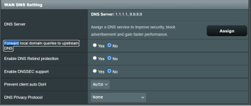

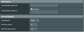

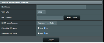

Post a screenshot of your WAN, Internet Connection settings. It has to work offline, if you don't forward local queries to upstream DNS.
