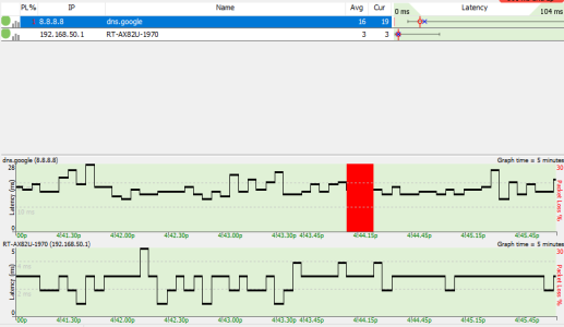

This post is more of an update from my last post with more information because I was wrong. I recently bought an AX82U and I have it connected to a Arris SBG8300 in bridge mode. I've had a reoccurring issue that would cause 100% packet loss to any connected session, but not from pc to router. It'd lag for ~7 seconds the be fine for ~5 and lag again. This happens almost every 10-15 minutes but only under some type of load. I found that it won't happen if I am just pinging a server constantly. I've attached a ping plotter image that shows the packet loss when pinging 8.8.8.8 and this will happen when my pc has any high internet using games or streams.
Old Post: This was my old post, but none of the solutions offered made any positive changes.
EDIT: I've found that the packet loss happens every 16 minutes almost on the dot
