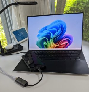

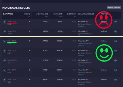

Hi All,*

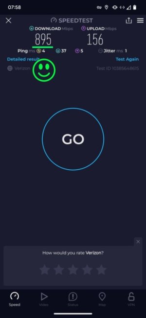

A couple of months ago, I was getting around 900 Mbps on my laptop but now it’s slowed down to less than half that. I have Fios 1 Gig. Nothing on the PC has changed. My phone gets 900 plugged into the same network with the same cable. If anyone has any ideas I would greatly appreciat it. TIA
DELL XPS 15 9520
PRO: 12th Gen Intel Core i7-12700H 2.30 GHz
RAM: 32.0 GB
STO: 500 GB
SYS: 64-bit op sys x64-based proc
OS: Windows 11 Home
VER: 24H2
BLD: 26120.1542
EXP: 1000.26100.18.0
Realtek USB GbE Family Controller 12.1.620.2024
Power management: Unchecked
Adaptive Link Speed: Disabled
ARP Offload: Enabled
Batt Mode Link Speed: Not Speed Down
EEE: Enabled
Flow Control: Rx & Tx Enabled
idle pwr dwn restr: No Restriction
idle pwr Saving: Enabled
IPv4 Checksum Offl: Rx & Tx Enabled
Jumbo Frame: Disabled
Lge Send Offlv2(IPv4): Disabled
Lge Send Offlv2(IPv6): Disabled
Misc Transf Settings: Enabled
Network Address: Not Present
NS Offload: Enabled
Priority & VLAN: Priority & VLAN Enabled
Receive Buffers: 37
Receive URBs: 6
Recv Seg Coal (IPv4): Enabled
Recv Seg Coal (IPv6): Enabled
Speed & Duplex: Auto Negotiation
TCP Cksm Offl(IPv4): Rx & Tx Enabled
TCP Cksm Offl(IPv6): Rx & Tx Enabled
Transmit Buffers: 37
Transmit URBs: 3
UDP Cksm Offl(IPv4): Rx & Tx Enabled
UDP Cksm Offl(IPv6): Rx & Tx Enabled
VLAN ID: Not Present
Wake on link change: Enabled
Wake on Magic Packet: Enabled
Wake on pattern match: Enabled
WOL&Shutdwn Lnk Speed: 10 Mbps First
*Please accept my apologies if this question is posted in the wrong place or generally improper for this forum. I've been lurking for years and respect the members' expertise immensely.

Btw, I posted about the phone just to show that the problem is not with the cable, the phone was handy. My other laptop gets 900 with the same cable.
