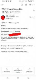

If you manually run right now and select option 4 (sample email), does it correctly display the lease time?
updated to 1.10, Added NTP sync wait (pinched from the famous JackYaz), re-download from link in first post
Should eliminate all issues recording dates/times in script. Script will not function if your router cannot use NTP to update date/time

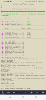

Hello my friend, for some reason email stopped sending.
To try to solve, I configured everything again, created new gmail app password, but same symptoms
Hmmm you seem to always have issues on alpha/beta firmwares. I cant debug these as I generally on run stable, with the exception of recently when I was on 386.1b3
For starters, HELO/EHLO isnt sending an ID, do you have a name set on the WebGUI under Lan-->HostName?
Is there a reason you need to use 587/TLS with Google? Can you try 465/SSL, it uses Curl instead.
Yes, I have name set on the hostname....
I was using 587 for no reason at all, it was working from the beginning, so I was using 587...
I changed now to 465 and it started working :)
Thanks pal
Thanks pal
Thanks for the follow up. My guess is it worked before for you, but then you updated to 386.2Alpha and didnt test it
587/TLS should work with Gmail (it does on 386.1stable), its likely something with 386.2alpha between sendmail and the hostname, Ill wait till 386.2 goes stable before looking into it more.
And my bad I forgot TLS was the successor and is what most people use but glad SSL is working through Curl for ya.
