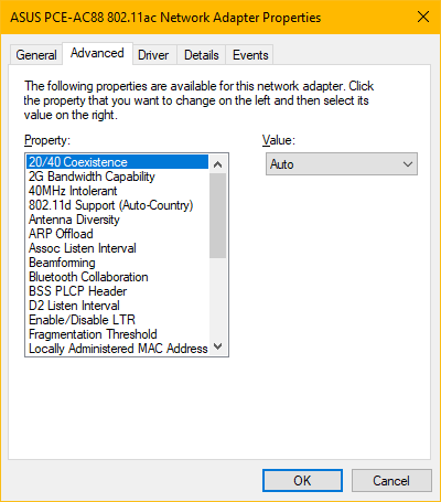

I have just found a way to reliably reproduce the issue.
After a network reset, when I am having no issues, if I edit ANY setting on this network adapter screen and save the issue starts to occur. Reverting the change does not fix the problem. I suspect it's setting some registry value... Somewhere...
windows networking has been buggy even for me and i get problems not just with latency but more of with the network adapter driver being stuck. MS blames drivers/manufacturer when it is a windows issue as it did not happen in older versions of windows, like the double click problem as well.
After downgrading the ASUS/broadcom driver to before KRACK was patched and performing a network reset, I can adjust any variable on that screen as much as I want and there is no problem at all!
However, there is no option to offload the rekeying so I'm screwed security-wise.
Do I want stable internet and massive security vulnerability.... Or secure WiFi but unusable internet..... lmao
KRACK is a client side vulnerability. So it's not an issue unless you're running your router as a repeater or media bridge.
