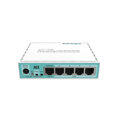

MikroTik hEX
Microtik is good HW - but I've had serious concerns with the overall security of their firmware...
They've had a lot of issues - not just with defaults, but late responses to vulnerabilities...
