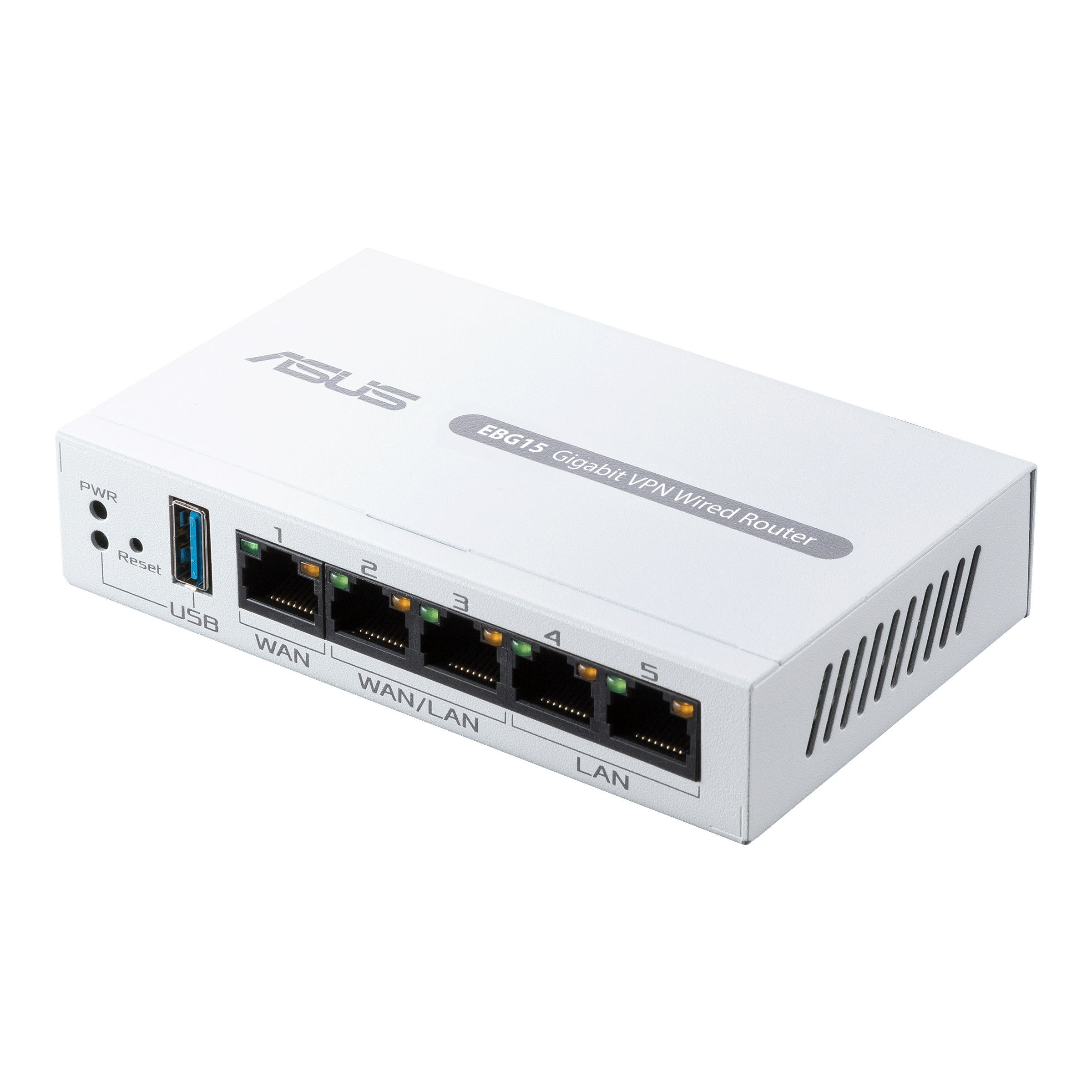

Want to play beta tester of a new product? The same CPU as your RT-AC86U wired only Gigabit router from Asus:
