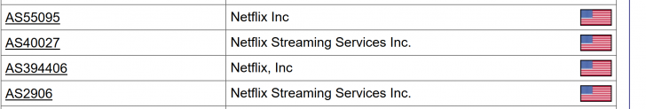

It looks like some changes may have occurred. In addition to AS2906, I see several new ASNs for Neftlix.
What is interesting is I don't see any traffic traversing AS2906 any longer. I created a separate IPSET list for each ASN. Only the AS40027 saw traffic traversing the chain when I watched Netflix on my laptop. But not when using a Firestick.
I then ran the autoscan.sh script and searched for netflix and nflx to see if there are any other domains.

What I looked at the IP addresses returned by some of the Netflix DNS lookup queries, many of them belong to AS16509 which is Amazon AWS in US rather than being owned by a Netflix ASN. Netflix hosts on Amazon servers.
From the testing I did this morning, it appears we may need to cast a wider net and also include one's local Amazon region or the GLOBAL region. I only used to use Amazon US region for my needs. But recently found a situation where I also needed to include the GLOBAL region as well. So far, it appears that if specifying GLOBAL region, there is no need to also specify the other regions like US.
Alternatively, I found that adding nflximg.com and amazonaws.com domain works.
x3mRouting 1 0 NETFLIX_DOMAINS dnsmasq=netflix.com,nflxext.com,nflximg.com,nflximg.net,nflxso.net,nflxvideo.net,amazonaws.com
I will do some more research on the ASN method for Netflix.

I had the same issue this morning. It worked yesterday. I added AS2906 and it is working now. For me, I am routing to my private VPN. Just change the "ALL 1" to "1 0" for your use case.
sh /jffs/scripts/x3mRouting/x3mRouting.sh ALL 1 NETFLIX-DNS dnsmasq=netflix.com,nflxext.com,nflximg.com,nflximg.net,nflxso.net,nflxvideo.net,amazonaws.com
sh /jffs/scripts/x3mRouting/x3mRouting.sh ALL 1 NETFLIX_AS2906 asnum=AS2906

Thanks again. It seems to be working now. I didn't have to add the rule for Amazon (yet) but I'll keep an eye out. Enjoy the trip!
