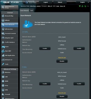

Guest Network #2 5Ghz enabled on RT-AC68U.
RT-AC68U configured for router mode.

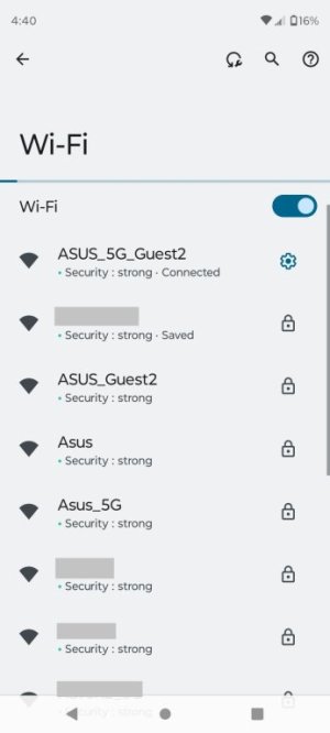

Mobile phone connected to Guest Network #2 5Ghz on RT-AC68U.

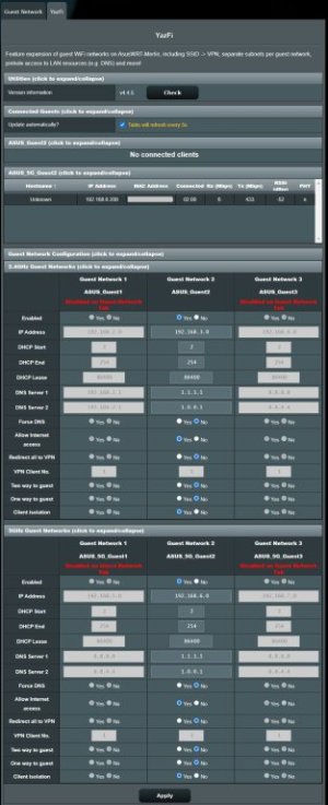

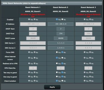

YazFi Guest Network DNS Addresses set to 1.1.1.1 and 1.0.0.1. (Additional YazFi settings can be seen in attached image.)
Mobile phone has internet access.

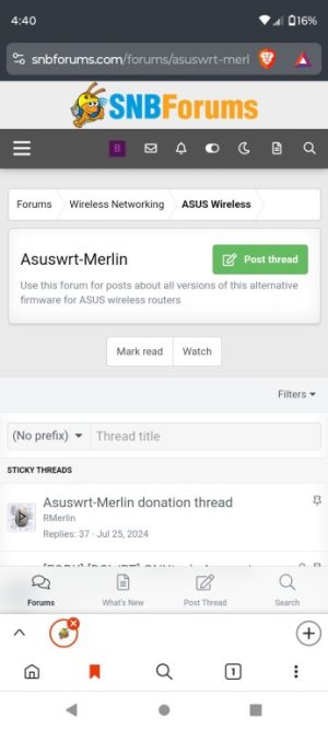

Thanks for the screenshots and the detailed breakdown of your setup.
From your suggestion, I disabled Guest Network (GN) #1 and switched to GN#2 and magically, guest devices had internet. Does GN#2 and GN#3 prevent devices from accessing LAN? GN#2/GN#3 don't appear to create new subnets.
I noticed "Access Intranet" on GN#2 was enabled by default. Does toggling this do anything on GN#2/#3? I noticed this is enabled in your screenshots as well - are these devices able to access LAN?
I installed YazFi 4.4.4 and enabled it for GN#2 and have the exact same setting as you @bennor, but now I no longer have internet on guest devices. I can see the devices connected to the guest network on the YazFi page.
The only difference between your setup and my setup is that my main router is connected from WAN (2.5G port) to WAN (2.5G port) of the subnet router. To rule this out, I even changed this so the main router is connected from LAN port to WAN (2.5G port) of the subnet router, but no luck.
When using YazFi, on the Guest Network page, Access Intranet is enabled by default. Do not change that setting. YazFi enables that option and handles the option to access the Intranet itself on the YazFi page (One way to guest, Two way to guest YazFi options). Note: YazFi will block access to the intranet on the router it is installed on. It will not block access to any up stream router/system unless you disable Internet access all together (Allow Internet access) from YazFi. YazFi only controls the firewall on the router it is installed on.
