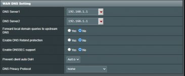

i cant see anything there that should fail validation. can you try via option 1 of yazfi over ssh please and let me know if it gives more info?
Seems that I missed a step possibly?
The only other thing out of the ordinary that I can think of would be what I did to setup the VPN client via the basic guide by the provider.
https://support.nordvpn.com/Connectivity/Router/1047410642/AsusWRT-Merlin-setup-with-NordVPN.htm
I'm not sure if this is important but I haven't set the WAN DNS like the guide suggested. Currently the Yazfi device points to the master router. This may be a separate conversation but it's the only out of the normal thing I have done since re-configuring my network. Also, for now I haven't touched the kill switch settings as mentioned in the guide either.
What is the IP address of the router running YazFi? Per your layout.jpg image in a prior post it appears that router's IP address is 192.168.3.1. If so, you appear to have a possible conflict since Guest Network 2 appears to be using IP address 192.168.3.0 in YazFi per image 1.jpg in an earlier post. Try adjusting the YazFi IP addresses so they don't use the same IP address range as the router's IP address range and don't conflict with each other and see if that clears up the error you are getting.
Indeed, you are correct. Not sure how I missed it. Probably because I wasn't paying attention to guest 2. Everything is up and running perfectly. Thank you very much for spotting that. :)
