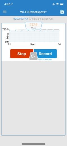

So far using the Beta i have experienced solid wireless connection. A video playing on loop has been playing for over 24 hours and still going strong. WiFi SweetSpots shows 750-800mbps all over my house. Smart connect is off. With smart connect on, I get 10-50mbps on WiFi SweetSpots and my thermostat and smart outlets have trouble connecting. In my experience Smart Connect gives terrible performance.
I am very happy.
I am very happy.

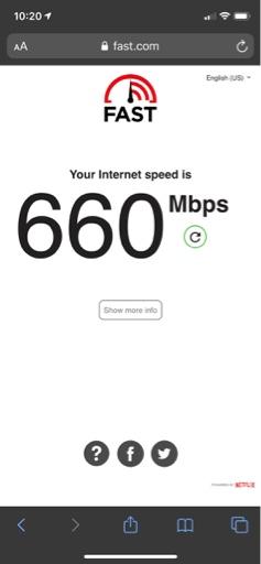

I pay for 600mbps, SHAW Cable. I get the max or higher all the time, all over my property. I have two XT8 and two CT8 units and one RT-AX92u in the shed in the yard. All connected with Ethernet backhaul. I have 39 devices connected to my network.
Thanks, I’m running mine with the Wi-Fi backhaul 5ghz2 and it runs at 160mhz with a -45 signal between nodes. Same experience as yours so no complaints.
