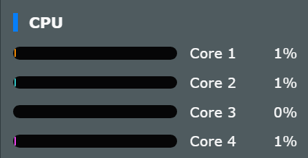

That's normal (and a good thing) if you have hardware acceleration enabled as the network processing bypasses the CPU. You will only see substantial CPU usage if you enable features that disable hardware acceleration, like QoS, AiProtection, etc. Here's my screenshot taken whilst doing a speed test from a PC.
