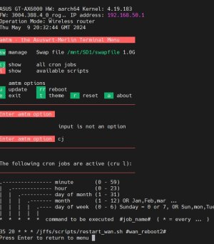

I'm attempting to execute a custom cron job path at startup, which will then trigger the execution of restart_wan.sh and /ss_rule_update.sh. I'll post the detailed code for several files for review. Thank you for your assistance.
