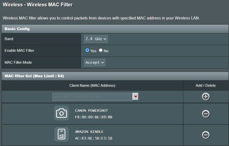

Or perhaps do what I and others have done and set both SSIDs to have the same name. That has resolved my issue. I've also added a Wireless MAC filter so that only devices that cannot use the 5 GHz band are allowed to connect to the 2.4 GHz band. That keeps everything else than can connect to the 5 GHz band from straying onto the 2.4 GHz band.
Thanks for that. It’s still unclear to me why this would make a difference. I’ll set it up on my LAN and try it anyway.
Actually, it's only partially resolved the issue, because my Canon camera (on 2.4 GHz) has stopped connecting to my laptop again when my laptop is on the 5 GHz (it was working a few days ago) and yet my laptop (when connected on 2.4 GHz) can still communicate with my Canon printer on the 5 GHz band.
