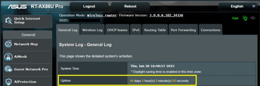

Not sure why you and others may be having issues. Have 44 days of up time (see attached) and during all that time 2.4Ghz and 5Ghz main LAN WiFi clients can ping/see each other. Didn't have any problems either when using Asus-Merlin with uptime measured in multiple months.
Uptime seems irrelevant to routers that experience the problem. When it happens the router can ping devices on both radios but packets from devices on each radio get dropped at the router. It appears to be a routing or iptables (eg in the forward chain) issue but no obvious cause has been found by anyone yet. A router reboot is the easiest fix.
