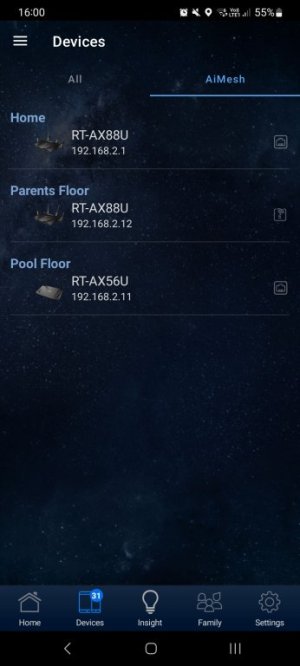

Just reset my AiMesh Nodes after a full network breakdown, the ASUS app stuck in AiMesh page, takes way longer than should to watch client list.
I hope this bug is not in the GPL itself, so it can be fixed by @RMerlin
If not, I hope ASUS can send a patch that could fix it prior Beta.
Anything related to the mobile app is outside of my control, since it's a separate application.
The webui delay is already fixed on my end, it was the webpage failing to validate the firmware version of nodes (a function from general.js was no longer being correctly imported by the AiMesh topology page).
