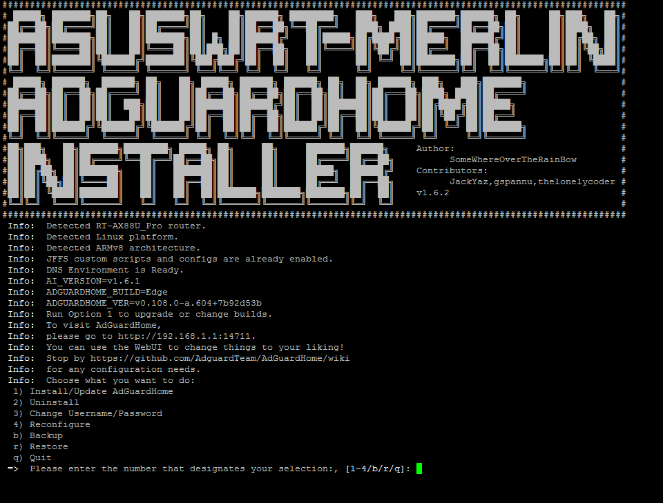

You guys will have to uninstall, and reinstall. Make sure to get screenshots of the actual terminal install process. This is critical for me to know if there are any errors in the process during your install.
As stated I have refreshed my router two times, vanilla settings. I've installed entware then adguard. Adguard installs fine as stated from the screenshot I posted, the installer (latest version) doesn't define me a port number to allow me access to the gui. It just defines the pot as a ip-address:dot nothing else. So I'm not sure how many times I need to vanilla set my router to keep getting the same end result. So, for now I'll just have to leave it off my router.
http:

That's the result of when it doesn't define any port to access the gui, this is from vanilla settings. Tried port 53, doesn't work, tried 14711 doesn't work, so I don't know, I'm stumped
@SomeWhereOverTheRainBow Strange, it's now working? But not sure why at the end of the install where it tells you to access it doesn't give you the port number on the end result, maybe it's the installer issue?
It is fixed, it was because the installer relied on parsing the port number based on the old value in the .yaml file. Since adguardhome developers decided to change this format in the middle of the night, it caused its functionality to break in the installer. After reviewing the issue, I was able to correct it.
