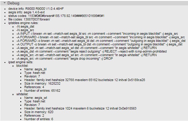

done update ............. but always the old one version 1.4.6
same here, upgrading via web didn't work. Afterwards it still said version 1.4.6
Also confirmed via commandline.
Upgrade via commandline did work though (aegis unset, aegis upgrade, aegis up)
