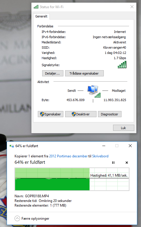

Hi
I have the new firmware 3.0.0.4.384_20287 in my GT-AC5300.
In one of my computers I have the ASUS PCE-AC88, with a reported Wi-Fi connection speed of 1.7 Gbps.
But I can only get a file transfer speed of 41.1 MB/Sec. Why is this so low?
The file is transferred from a QNAP TS-563 with SSD disks and aggregated ports to the GT-AC5300.
When I try from a wired connection, I get a file transfer speed at 110 MB/Sec.
Hi
Is your computer your transferring from also a SSD? I can see this happening when the host machine doesn't have SSD because read data is much slower.

The read/write to/from NAS test is done from the same computer - first test Wi-Fi and then Wired.
Therefore the Wi-Fi test it should be at least the same speed as the wired.
