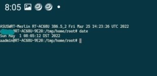

So then I am definitely missing something. Screenshots attached.
Router is set to PDT.
Time is just after 8am
Leds are set to come on at 1300 and off at 600
Right now the option offered in amtm is to "disable" the leds implying that the leds are on. I can also confirm that the leds are actually on.
If this was scheduled in local time the leds should be off but they aren't.

XXXXXXXX@RT-AC68U-9E20:/tmp/home/root# cru l
0 13 * * * /jffs/addons/amtm/ledcontrol -on #amtm_LEDcontrol_on#
0 6 * * * /jffs/addons/amtm/ledcontrol -off #amtm_LEDcontrol_off#
Times are correct for UTC and these turn the lights off at night and back on in the morning. Still confused.
The times shown in the output of the cru command are in the local time zone, not UTC.
So if you want the LEDs to turn off at 22:00 local time for example, the entry should be 0 22 * * * /jffs/addons/amtm/ledcontrol -off
If crond is not operating in the time zone set on your router then something has gone wrong.
Look in the router's syslog just after it's booted up. You should see a line similar to this just after NTP sets the router's clock:
Apr 29 19:54:11 crond[1455]: time disparity of 2096029 minutes detected
You can try manually restarting crond and seeing if that fixes the problem:
service restart_crond
