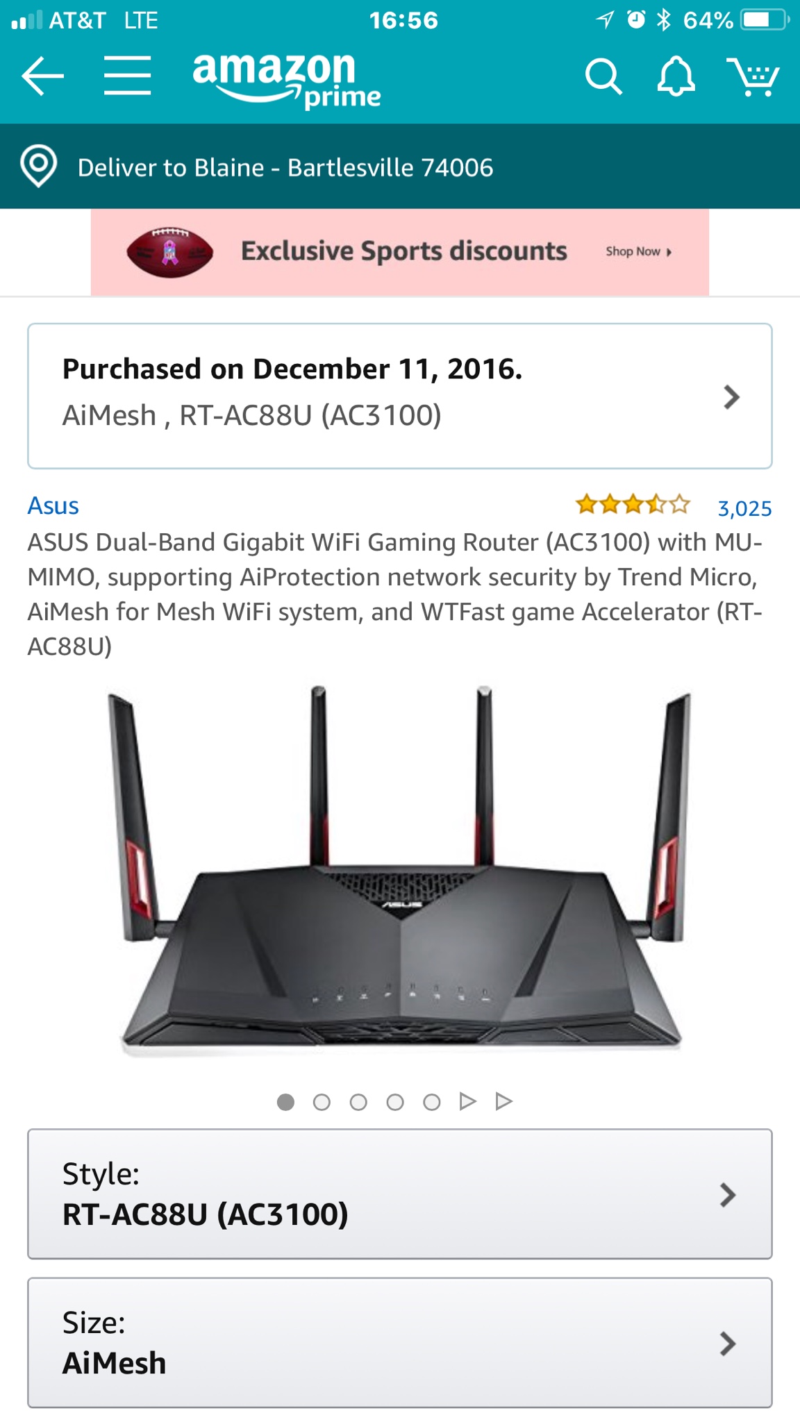

Might be a bad time to ask but I SHOULD be using 88u firmware, correct? It definitely has 8 ports on back but sticker on bottom says 3100? Amazon I bought it from lists it as both 88U and 3100??
If it's got 8 ports then it's an 88U. This confusion has come up before with this model. I think it's because it's an "AC3100-class" router and there happens to be another router called the RT-AC3100 (with 4 ports).
Crap was hoping that’s what problem was. Gonna try to roll back to Asus firmware later tonight or tomorrow evening. So tired of messing with it ‍♂️[emoji26]
