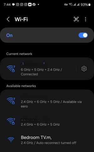

BTW I have a new issue with this V2 router, With the V1 router I was able choose 3 band MLO WiFi , as a combination 6G+5G+2.4G from my S24 ultra phone. as below.
But now I can only see one band, either 6G or 5G or 2.4G :( Frustrating...

Figured out the issue, the ssid has to be unique
