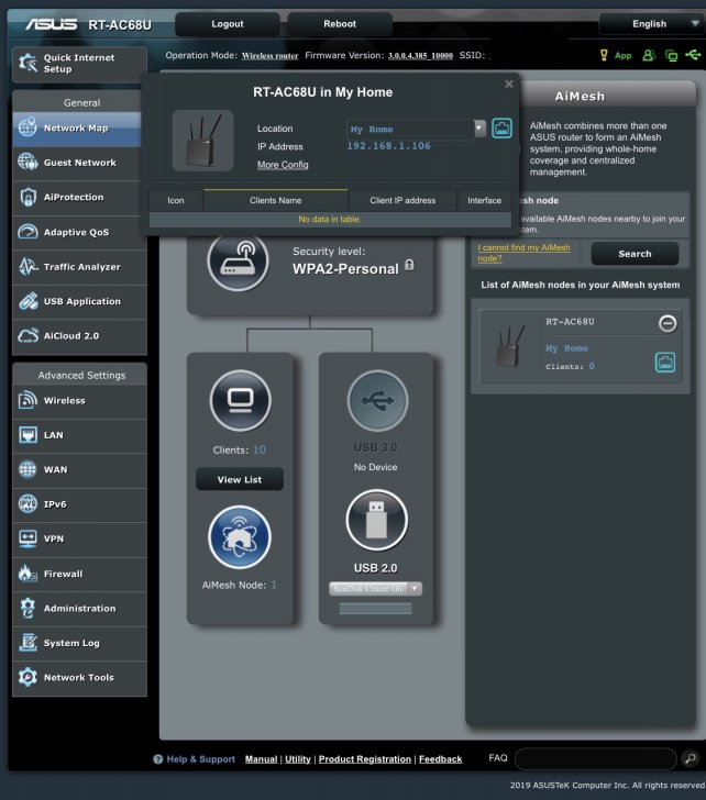

Okay, I got the same result (as below) when I installed 10000 on my main (68R) and AiMesh node (68U) routers, as I've had on all the firmware updates since 45717
Installed 10000 over 45717... on both my main 68R snd AiMesh node 68U
My hardwired 68U node dropped it's wireless and hard wired connections, except the one to the main router.
Getting WLCEVENTD wlceventd_proc_event(420) & (449) entries on the wireless devices near the node in the system log. The 68U node's hardwired device is not on the device list in the Network Map.
Reinstalled 45717 on the node... My node's hardwired device came back on the Map.
Rebooted both routers.. Everything is connected again and no more WLCEVENTD messages...
==> is this a "known" bug for the AiMesh node router?
==> Do I need to do something additional on the node to "fix it" post update?
Thanks!
>> Tom

Hey lucluke
My "obvious" solution was, after the upgrade to 10000, to do a factory reset (duh) on the node router first, then the main router, and no more disconnects!! ( see a later post from me.).
Also check previous posts on how to set a log_level parm to eliminate informational disconnect messages.
