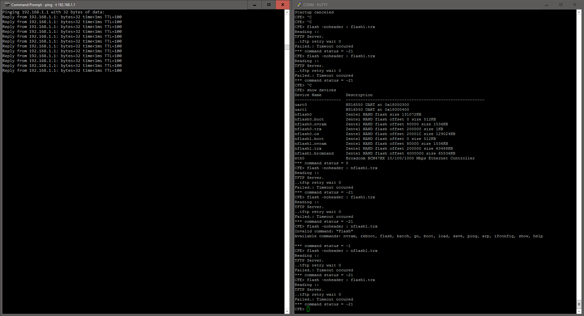

What are your ping responses? If it's not ttl=100 you won't be able to upload the firmware.
Try using the firmware restoration tool while the ping s ttl=100 if you aren't able to use flash -no header or the cfe mini web server.
its not connecting to the device
then says router is not in rescue mode.
is there a way to increase the TFTP retry timeout because it gets timeed out when uploading the 40MB Asus official FW using tftp2.exe

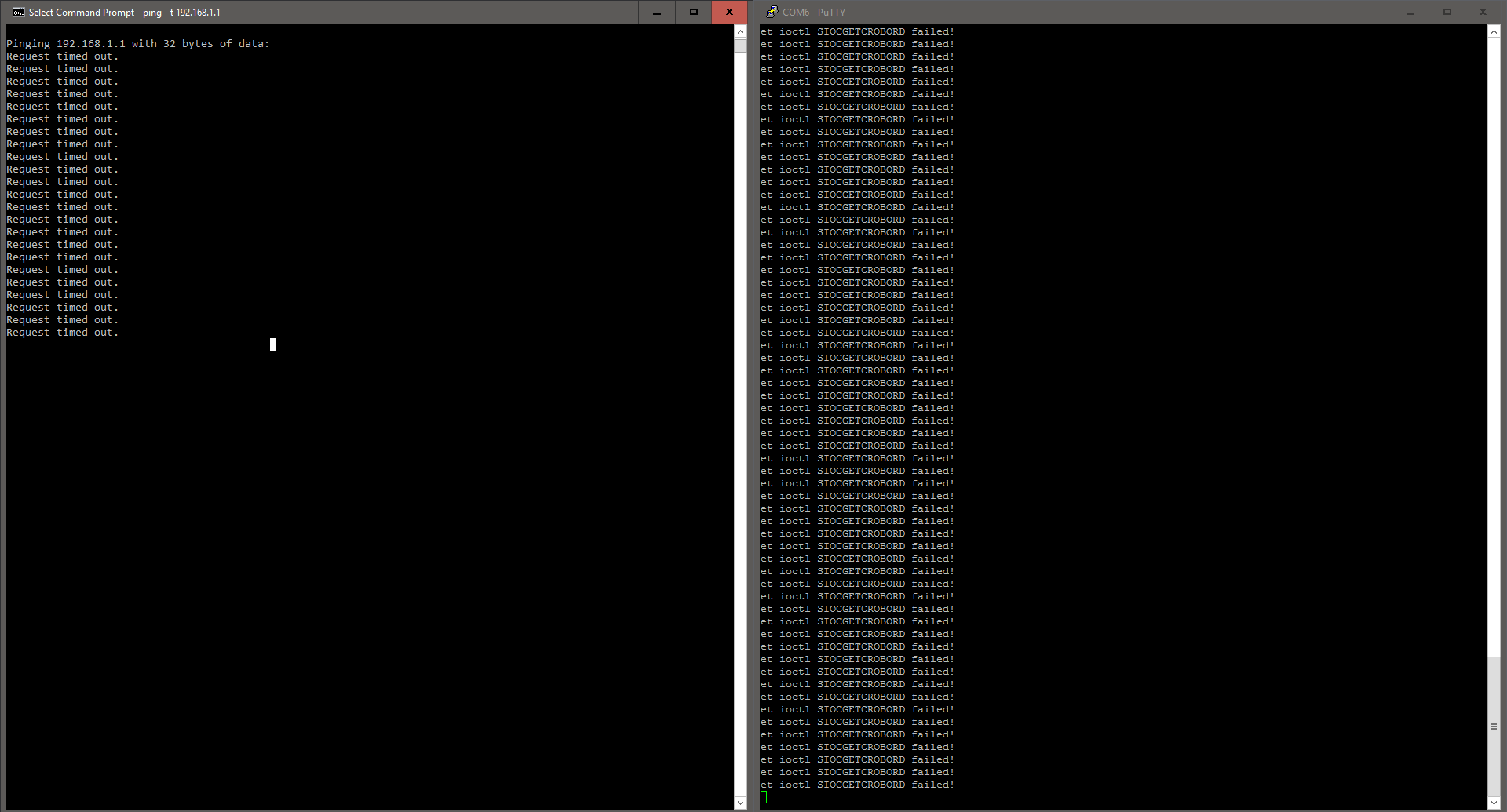

Also if you can just look at this logs and tell me where I can go from here.
Use tftpd32.
