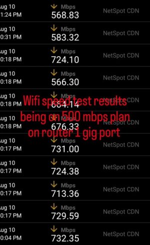

But did you read everything I said on 500 mbps plan speed test from modem to router was giving me test results of way over the 500 mbps also wifi speed test was giving me results of way over 500 mbps..........
This 1 gig plan is giving me modem to router speed test results of under 1 gig my wifi speed test results are as if I'm still on the 500 mbps plan look at screenshots

Bro your not understanding yes I know this phone won't get 1 gig but seems like I was getting more worth my money paying for 500 mbps plan because at least with that it seem like all my speed tests results were over 500, now I'm getting under 500 like wtf

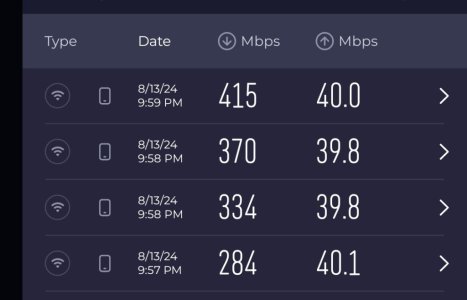

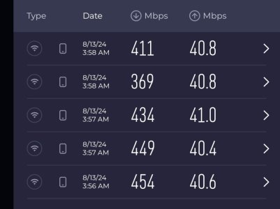

.... but men I'm not even seeing the same Wi-Fi speed tests results as before on spectrum 500 mbps plan all my wifi speed test were over in between 500 mbps to 700 something mbps now look at screenshots look at what I'm getting

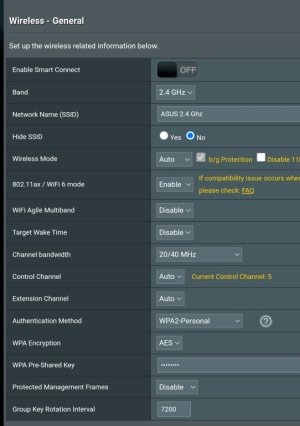

It appears from the two images you posted you are using different speed test programs and different end point servers to test your speed against. That may result in different results.

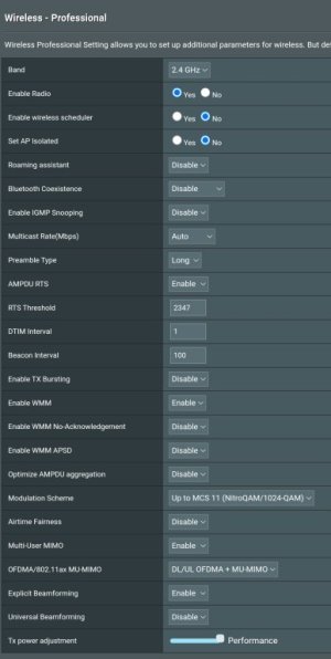

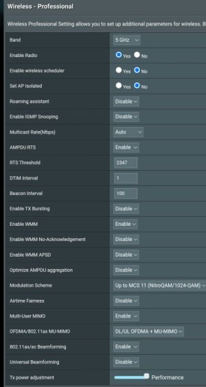

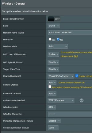

You may want to post readable screen shots of your WiFi settings redacting any sensitive information so others can look at your WiFi settings to see if there is anything that should be adjusted or changed. As already indicated by others, your WiFi speed is likely to vary based on your local environmental variables. Check the Client List to see what it indicates for the WiFi client.
Well it's 4am I did several speed test from same app and I'm still not getting results of over 500 mbps being on 1 gig but on spectrum 500 mbps I was getting speed test results of 500+ Mbps
I put screenshots of 2.4 and 5.0 settings on top

It is becoming confusing (at least to me) exactly what your issue is.
Your WiFi speeds will be dependent on the capabilities of the WiFi hardware on the phone (or other WiFi device). As others indicated you likely will never see close to 1GB WiFi speed unless you have WiFi 6 (160GHz) capable WiFi hardware on the phone or other mobile device and even then one may never see the full marketing advertised WiFi speed.
Your first step should be to test a computer directly connected to the broadband provider's equipment using Ethernet cable (do not use WiFi). Test the broadband speed with the Asus router out of the mix with only the computer directly connected to the broadband modem or gateway. Verify that the Ethernet connected computer is reporting the speed you are paying for with the Asus router not connected. If you are not getting the speed you are paying for, contact your broadband provider support line and have them check the line to ensure it was properly upgraded from 500MB to 1GB. Mistakes do happen and sometimes the line is not properly provisioned.
Note that broadband companies typically do not, on consumer lines, guarantee you'll receive their advertised maximum speed. They all use fine print language like "speeds up to 1GB" which means you could see 1GB speed or you could see 200MB speed. Further one's broadband speed can be affected if the broadband provider over provisioned the line and your neighbors or family members are all using that line at the same time (like evenings or after school hours).
Next, connect the Asus router to the broadband provider's equipment. And use a Ethernet wired connected computer to test the broadband speed. Do not test using WiFi at this point. Verify using a Ethernet wired computer with a Gigabit capable Ethernet port. If the broadband speed test verifies that you are receiving close to 940Mbps then you are receiving the speeds you are paying for (assuming 1GB plan speed).
Only then should you move to looking at the WiFi speed. Check the WiFi specifications for your WiFI devices. It is possible your WiFi speed may be limited by the capabilities of the phone's or computer's WiFi hardware. If the client device WiFi hardware is WiFi 6 capable then ensure the router has DFS/160Ghz enabled in the WiFi settings. Typically WiFi tends to be slower (for many reasons) than wired Gigabit Ethernet. Check and post the System Log > Wireless Log page on the router. See what the router indicates for the WiFi device's connection. For example, if it indicates the WiFi connected phone has RX/TX connection of 300/300 Mbps, then the phone will typically be confined or limited to that 300 Mbps speed (or what ever speed the router indicates the device is connected at).
So post a screen shot of that Wireless Log page for others to see what you are seeing for what is being reported by the router for WiFi connected devices. Redact sensitive information if needed.

OP has changed many of the setting in the wifi professional setting and some will decrease your speed.
Should have left them on defaults except for disable roaming assistant.
Using the 2.5 port for WAN will help get max speed for wireless.
Like what was said, post wireless log so we can see the link speed of the devices.
I have Multi-User MIMO and OFDMA/802.11ax MU-MIMO disabled should I be having them enabled???
It may cause issues.
