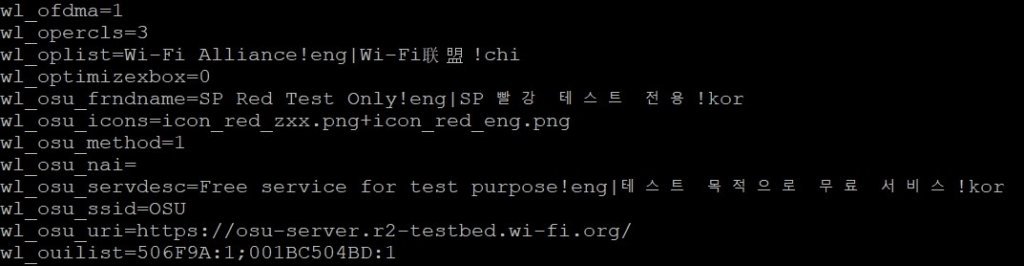

Installed this firmware on my 88u and had all kinds of trouble connecting to it afterward. After managing to get connectivity, I SSH'd to the unit and dumped the NVRAM.
This is a few lines from that dump:
wl0_oplist=Wi-Fi Alliance!eng|Wi-Fi!chi
wl0_optimizexbox=0
wl0_osu_frndname=SP Red Test Only!eng|SP !kor
wl0_osu_method=1
wl0_osu_nai=
wl0_osu_servdesc=Free service for test purpose!eng| !kor
wl0_osu_ssid=OSU
wl0_osu_uri=https://osu-server.r2-testbed.wi-fi.org/
Don't know about you but to me they definitely look weird. The only thing I could come up with is that "osu-server" has something to do with Discord. (???)
Careful installing this fw.
For your added enjoyment, this is actually what my PuTTY terminal showed me.
:eek:

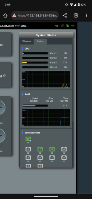

I decided to jump on and see what's the story.
All good for last 24 hours.
2 ax88u in mesh, wired backhaul. Using smart connect at -65.
+- 30 clients, 10 wired. 1Gbe wan, 2 wfh full time.
Memory usage seems down 6-8%.
