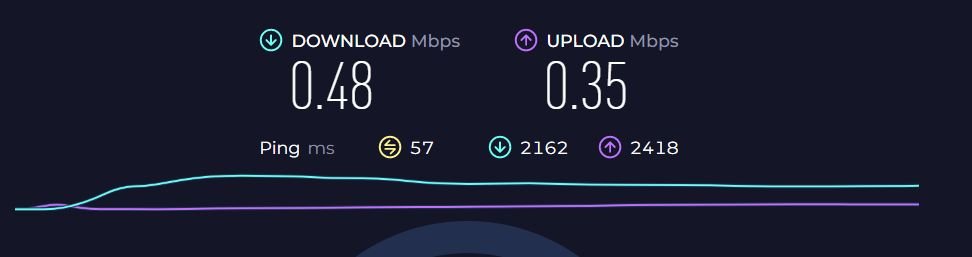

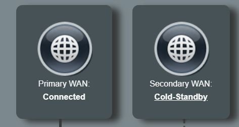

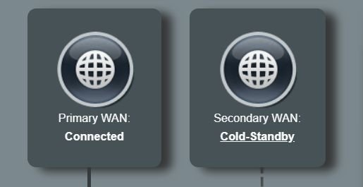

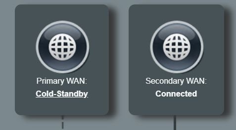

It did seem to work OK by unplugging the fibre optic cable, but the speeds were appalling. However, that's not the router's fault as I got similar speeds by plugging the device into my laptop. I guess that either the dongle or Smarty service is poor in my area (probably the latter).
