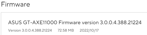

So I guess I was either one of the lucky or unlucky ones where mine didn't auto update., or maybe it tried but for some reason it keeps failing. I keep saying update it and it seemingly looks like it processes and flashes it then reboots itself only to come back up still on the same version and flashing its "hey update available" icon. Any idea why it keeps failing and more importantly should I even be trying to get it as it seems lots of people are having issues?

It was the same with me. The router seemed to be trying to protect me from this firmware, but I didn't listen to it and got what I got. Don't repeat my mistake — skip this version.
How can we make it stop? How can we block the automatic download of this firmware? Anything above 47875 turns my mesh environment into shirt. Current setup is AXE11000 as the main router and 3 RT-AC5300 as mesh nodes and all works great until the update to 22238. If a solution cannot be found, lookout for all this gear on craigslist. Then the question becomes what do I replace it with.
I'm in the same boat as this firmware version, as does 3.0.0.4.388.21224, wrecks my Wi-Fi performance (same as https://www.snbforums.com/threads/gt-axe-11000-version-3-0-0-4-388-21224-just-released.81369/) - and nothing obvious that I could see as to why.
I downgraded to 3.0.0.4.388.20499 and the router literally auto-upgraded again to 3.0.0.4.388_22238 right away, with auto-upgrade off.
For now I've set auto-upgrade on with a time of late tonight, hopeful this will give me a bit of control over this but this is very frustrating and disappointing from Asus. This may push me to WRT-Merlin.

Personally, I was able to defeat this firmware only in this way: update via recovery mode, settings reset, complete router reconfiguration. Positive aspect: everything works fine; negative: update took a long time.
I really hope this auto-update thing is not the new norm because I have some friends running Asus routers on older than latest firmware and it's done intentionally. If they auto-update the eventual problems with new firmware turn into my problems. :confused:
Moreover after manual update to a new firmware (autoupdate didn’t‘t work) my router went into a cycle reboot. I had to go back to the previous firmware via recovery mode. But if anyone wants to take a chance, watch a changelist:

Thanks to share, it had updated to this 22238 version automatically but I found the Mesh still not stable or connect at all unless I reboot all network switch, hub & some device. Also, the 6Ghz radio that I had disabled and hide SSID setting are not working use. I can see the SSID for 6Ghz radio. Anyone has idea?
Personally, I was able to defeat this firmware only in this way: update via recovery mode, settings reset, complete router reconfiguration. Positive aspect: everything works fine; negative: the update took a long time.
I mostly did this but didnt do the settings reset and complete reconfiguration manually but that will be my next step. Close to bailing on this and buying a dream machine.
