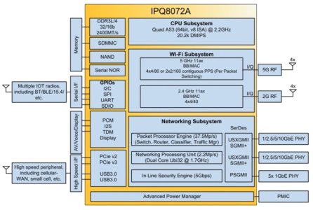

I've seen similar claims - Qualcomm IPQ8065 is a good example - It's a dual-core Qualcomm Krait, also also includes two ubi32 nss cores - I've seen some quote this as a quad-core setup, which is technically true, but I would consider it a dual-core chipset...

Not sure if they ever changed it for current BE generation, but AX gen IPQ8072/A was similar with NSS on chip. Original clock speed was 1.5ghz at launch.. Got boosted to 1.7ghz with "A" revision.

IE: IPQ8072A + 4x4 + 4x4 chip is linear to a BCM4912 + 4x4 + 4x4 with NSS/NPU on radio side.

Something like an AX88U PRO woud have a true A53 quad + 1.7ghz NPU functionality separate to each 6715 4x4 radio. Which is closer to What Qualcomm does in one bigger SoC.
