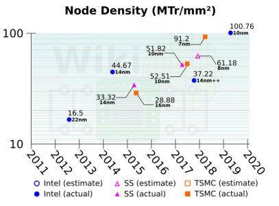

14nm Samsung and 16nm TSMC are a similar density. QCA HW has been on 14nm Samsung FinFET for a bit now (2018+)
Broadcom sticks to cheaper nodes because they value pricing/yield, etc. I would assume TSMC finally offered them a deal to move up to 16nm.
What? So there are pros of using a 16nm process over 7nm, other than cost?
You know that Filogic 880 from MKT uses 6nm quad-core A73, Networking Pro 1220 from Qualcomm uses 14nm quad-core A73, while BCM4916 is still on quad-core A53 (or B53 if you prefer), with a likely 16nm process, which is significantly lagging behind, right?
Again, I think mostly it'll be down to cost - something like 7nm is going to be more expensive than a 12/14nm node, and those will be more than 22nm where we first saw FinFet, and 28nm planar...
Consider that if the major elements, in this case, the switch in the SoC - if it's still at 28nm, then why do a shrink down?
The fabless vendors like Qualcomm, Broadcom, Mediatek - they have to license the tools and the utility libraries from companies like Synopsys and Cadence, and that even before buying into a node process from TSMC, SMIC, GloFo, Samsung, etc... and all the fabs have their own design rules about which tools to use, and how to integrate into their process...
There's a lot of data points to consider when making a decision to commit to a fab and which node to use...
Fabless companies are also subject to set order wafer cost.
It's sometimes more logical to go smaller if the yield is high. Depends on the overall logistics and design constraint.
NVIDIA went 8nm Samsung for Ampere because TSMC wouldn't really budge on 7nm. 8nm SS is a crappy node, but it made sense given the kickbacks.
