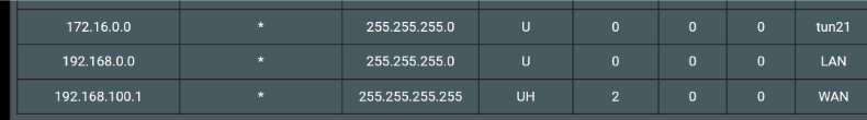

I finally got it to show but with metric 2? I did enter 1. Anyway I still can't access my modem. I can access it fine with the computer directly plugged in.
