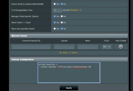

I have client to client enabled in the checkbox as seen and it works as long as I don't have the custom script that assigns static IPs enabled. When I add what is in the box at the bottom to run the clientconnect.sh to assign static IPs the client to client quits working. Do I also need to add client-to-client in the box field with the script? How would it look instead of like this?
script-security 2
--client-connect /jffs/scripts/clientconnect.sh

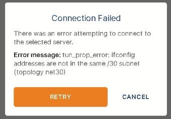

Let me also ask you this. As you can see in my config I have devices assigned to 10.8.0.11, 10.8.0.12, etc. but I was reading that they should be set to multiples of 4+2 such as 10.8.0.10, 10.8.0.14, etc. The problem with that is that once the number gets so high I end up receiving this error. For example this was the device trying to use 10.8.0.42.

There are two (actually three, but we'll leave out the 3rd for now) ways to configure the OpenVPN server. Either w/ net30 or subnet topology. The original script that you posted assumed a net30 topology, where each IP in the pair represented a local (client) and remote (server) IP for the client connection. IOW, it creates a /30 network w/ those two IPs as beginning and ending IPs. In order to prevent those /30 networks from overlapping, the instructions tell you to increase their values 4+2.
All that's fine and well under normal circumstances. But the use of a net30 topology means you lose communications between those subnets (i.e., the clients)!!! IOW, the very thing you're trying to establish.
As I said before, I don't know for sure if your OpenVPN server is configuring itself as a net30 or subnet topology unless I can see the server's config file and/or the syslog. Given the error messages you're getting, I suspect it is net30.

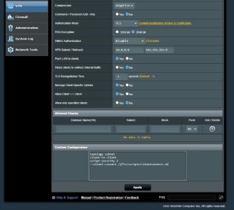

So what I want you to do is use the script changes I suggested (the one w/ the 255.255.255.0 subnet masks) *and* add the following to the custom config field.
topology subnet
client-to-client
This will *force* the OpenVPN server to use a subnet topology (just in case it's defaulting to net30), which will be consistent w/ the changes made to the script. And all your clients should now be able to communicate since they're all on the same subnet.

Yes. In fact, it defaults to a subnet topology. But as I stated above, you should be able to change it provided the OpenVPN server GUI has a custom config field, even w/ the OEM firmware.
Yes it seems to default to net30 with no option of changing it except maybe the custom configuration. I have changed all of my IPs in the script to multiples of 4+2. Would I add the code you suggested into the script like this?
